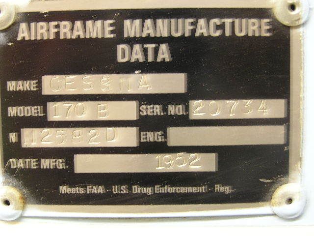

According to the EAA, "An 'Aircraft Identification Data Plate' is the plate that the FAA and US Drug Enforcement Agency mandated back in the mid 1980s that duplicates some of an aircraft’s data plate information on the outside of the aircraft, allowing DEA agents to quickly identify aircraft. ... Note that this external identification is not required to be on a fireproof plate. (The manufacturer data plate takes care of that requirement.) It only needs to be legible to a person on the ground and must be located as specified. Also, this identification should not be on an access door or cover, or anywhere where it would be removed or defaced during normal service. This external ID can be painted on, put on with a decal, or in any manner that is legible."

A nice way to comply with this on an original/classic airplane is to simply stencil/paint it on the left fuselage beneath the left horizontal stabilizer. Since the mfr (Cessna) already placed the datatag/I.D. plate at the pilot's door (aft sill), then all one needs do is paint/stencil "170X - SN99999" on the side in small letters/numerals (using your own model/serial, of course.)
