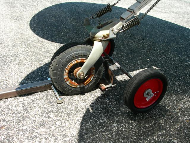

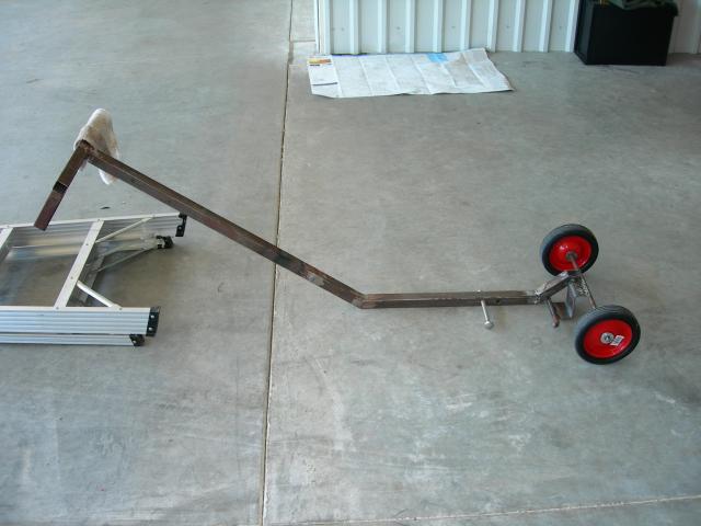

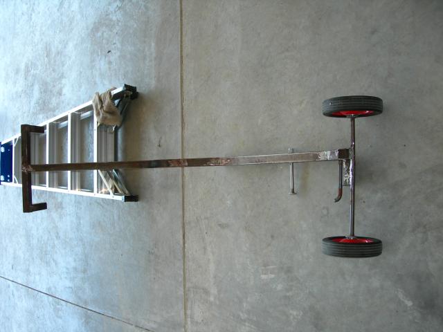

Here are some pics of the dragger my friend made:
Sorry I can't rotate the last one - I'm at work and don't have the original images here. Yes, my tailwheel will probably spit grease at you if you walk past :lol:
Hope that helps!

tshort I have a similar "taildragger". I used it on my Champ with no problems. however, after using it on the C170 for several months I noticed chips in the metal wheel lip on the side the metal bar contacts the wheel. I can't prove it, but I suspect the "taildragger" is responsible for the chips in the metal wheel lip. I wwnet back to the classic style that clamps onto the tail wheel axle.
