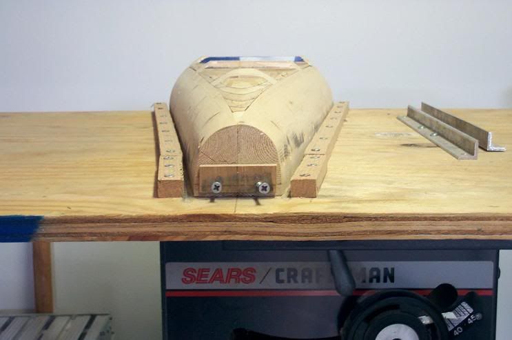

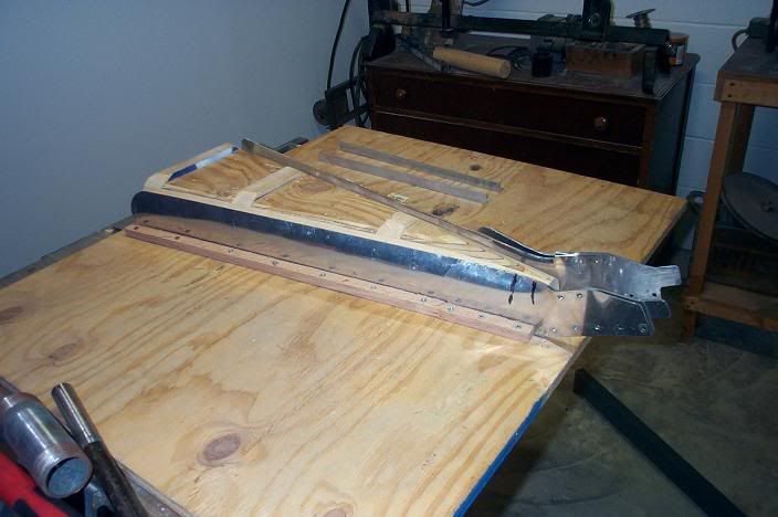

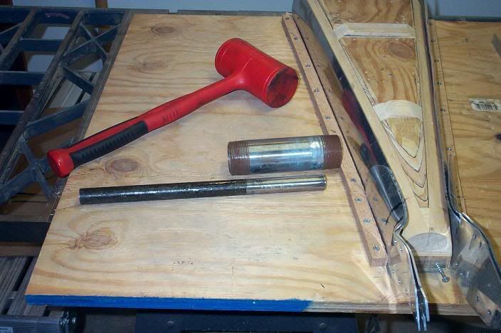

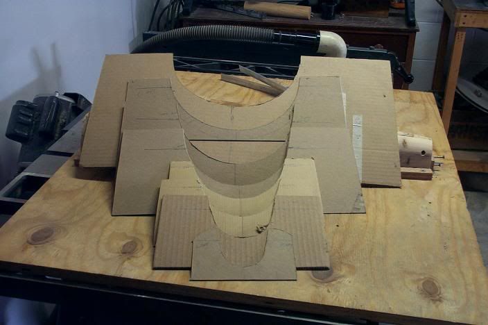

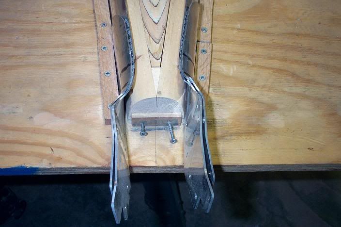

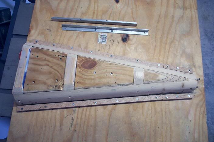

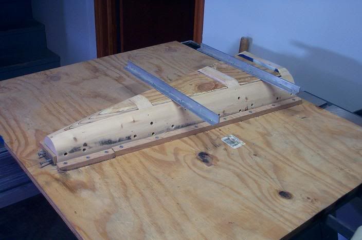

Here are some pictures of my tooling. (you should be able to click them to make them bigger)

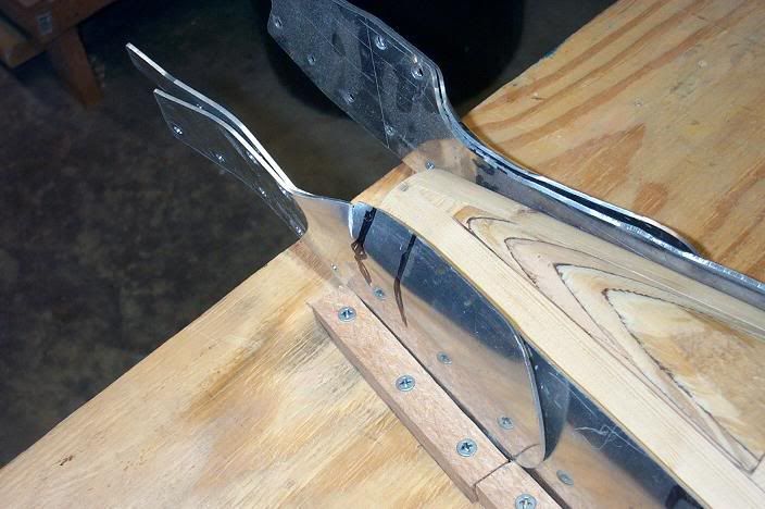

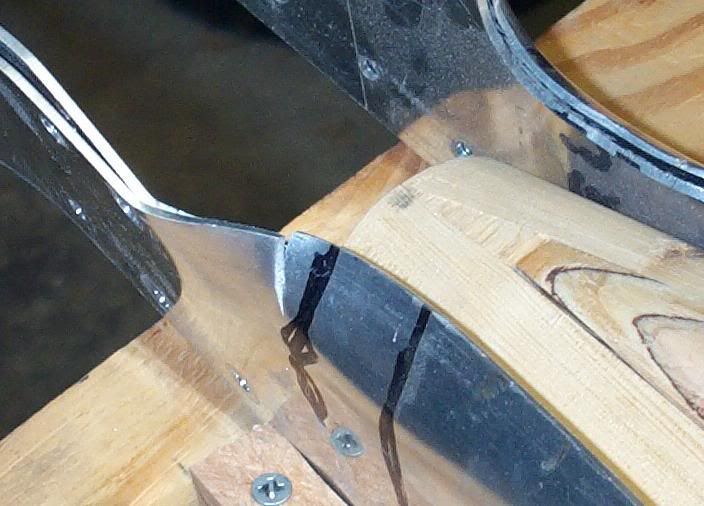

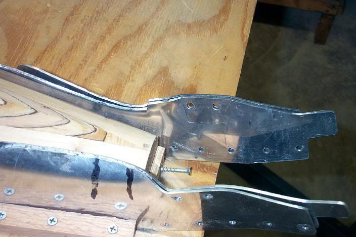

Jimmy, you'll see a tear in my first attempt as well. I decided that it was a result of the manufacturing technique rather than reaching the metals failure point. I used the pieces of pipe to form the curves on the second attempt with no problems. I also had the channel, block and springs installed while doing the forming.
The AC43.13-1B has the recommended minimum 90 degree bend radius for 2024-T3 .064 at 3t-5t and .128 at 4t-6t. It also says that alclad sheet may be bent at a slightly small radius.
I used the big deadblow mallet to keep the hammering to a minimum and I'm within the minimum bend radius so I don't feel to concerned about the longevity of the parts but as I said, time will tell.

Mark..........Thanks for posting the pictures,I really appreciate it. I took a few of them over to my woodworker buddy ( fishing partner ) and we'll work at the form this week.Your system looks like it will work better than mine.
