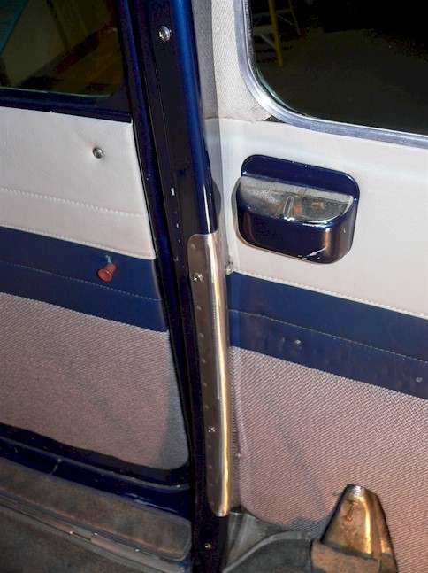

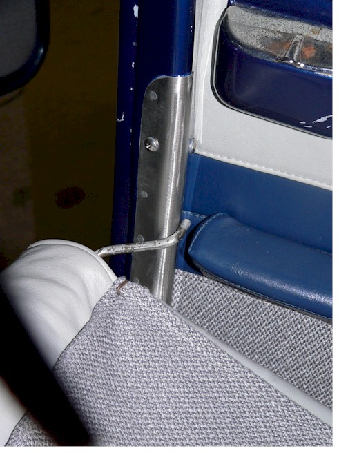

Kyle wrote: I had gotten really tired of damaging the plane taking the seat in and out. So, based upon some ideas from the association, and a few of my own we made the following modifications.
Rear cabin door post trim plate. We added a thin stainless steel doubler plate to the vertical post. The doubles was a bit difficult to make as it has a compound curve. It was riveted, ensuring the rivets once bucked did not interfere with the cables running vertically behind the plate. Additionally, the edges have a slight camphor to ensure it matted really well to the original piece. The original locations of the mounting holes were retained. This doubler plate protects the piece from the locking tabs on the seatback.

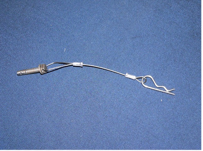

Removing the seat can be a real pain, the seat back attachment bolts were replaced with bolts that I through drilled at the bolt head and at the correct distance using only two 1/4" steel flat washers and a hitch pin to hold it snug. The wire is 1/16" stainless bicycle brake cable, and the hitch pins are 3/32" diameter.
Doug
Posts: 21295
AN hardware such as an AN-932 Clevis Pin might be a slightly neater adaptation of this idea.
A Quck Release or "PiP" pin might also work (and what I expect to do next time my seat is out.)
