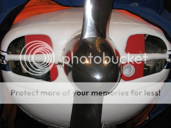

I ran across this pic from last year, seemed to work fine
This is the hole up front it is not square on my 57 c-172 it is a 3x4. one guy told me and inspection plate from a rag plane pops right in there, I haven't tried that yet
Blast tube.....well I'll tell I don't know much about airplanes but I will tell you in the modern dairies they have this little 14 inch square chill plate that will cool 10,000 gal of milk from about 101F down to 36-38 degrees in less than 24 hours. Now to get a visual that is a little more than a semi load over that small plate. Now if I was gifted like my friend Miles he would get out his little ruler inside a ruler and start talking about pie squared and all that stuff......all I know is it works so I would think the blast tubes certainly would effect your oil temps.....besides I don't mind if my pie is squared as long as it comes with icecream
