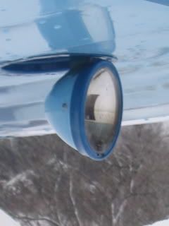

George,gahorn wrote: That's good info, but my earlier comment is quoted out of context.
Yes, I took your comment out of context, but not with any intent to misrepresent your point, only for the sake of brevity. You are right: When the pilot looks at the light in the down and on position, he or she can tell whether it is on or not! However, that does not mean that the function of the filament shield is to " 'block' the light emitted by the filament from being reflected by the outboard reflective surface, towards the cockpit."
Reading various patents pertaining to filament shields in sealed beam lamps has satisfied me that such shields were not designed to prevent direct light from reaching portions of the reflector of a lamp until sometime in the late 1970s when they were proposed for that purpose in rectangular headlamps.gahorn wrote: The earlier comment was speculation that the bulb has other applications and that the shield may have other uses in those other applications.
My own observation indicates otherwise. The reflector of my recently-failed 4522 shows damage to the reflective surface on the same side of the lamp as the filament shield. It appears that, rather than preventing premature heat damage to adjacent surfaces of the reflector, the shield contributes to such damage. I think this can be attributed to the fact that the shield is designed and constructed to block light and not to reflect it. This fact is supported by patent information pertaining to materials used to construct filament shields. Blocking light in such close proximity to the filament (whose temperature is in excess of 2200 degrees Celsius when the lamp is lighted) causes the shield to become excessively hot. I think if you installed a 4522 with the shield in the up position you would subject the upper reflective surface to accelerated, rather than delayed, damage.gahorn wrote: A 4522 lamp (in a different installation) facing forward and oriented with the shield UP, would help protect the upper reflective surface from premature damage.
As the photos below show: from the pilots seat, only a sliver of the face of the lamp is visible; from the front edge of the windshield (outside the plane), the shield is visible and may, or may not, be masking a portion of the filament; and from the spinner, nearly all of the shield is visible, but the filament is not visible.
I think these pictures prove that orientating the shield on the inboard side of the lamp will prevent light from being radiated directly from the filament to the forward area of the aircraft where it could create an unwanted distraction by illuminating the spinning prop.
