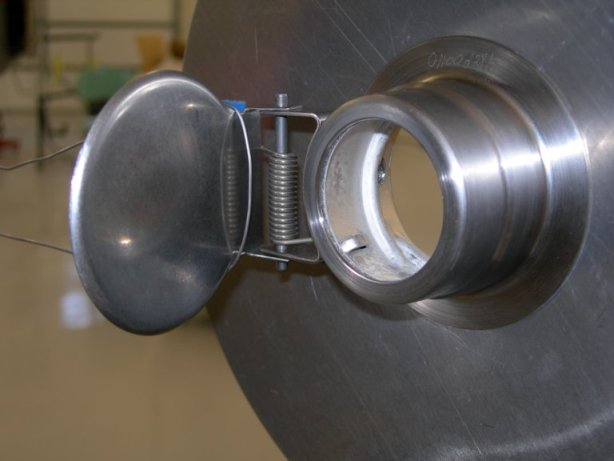

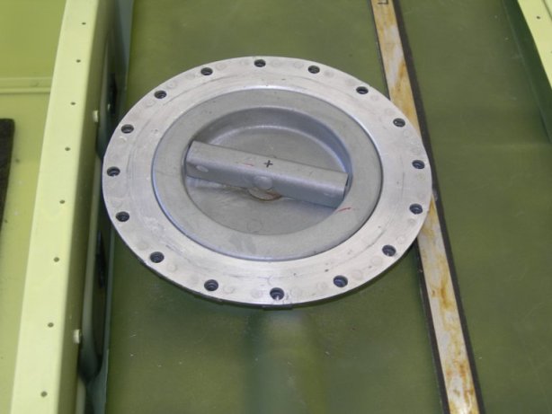

1. Original cap and fabric termination flange. If nutplates are not installed, then installation will be required as seen here. Used floating plates MS21059-L08.

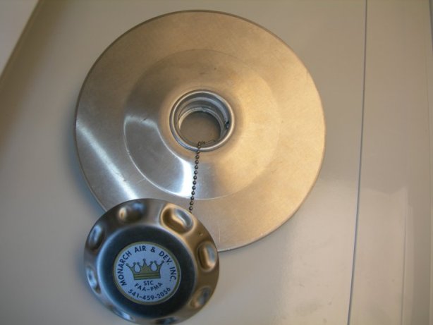

2. The tank adapter (Hartwig p/n FC0006) will need to be ordered undrilled as a blank. The cap is p/n FC002.
3. This is after trimming to fit the fabric termination flange. Requires approximately 1" to 1 1/2" to be removed in order to match the tank flange.

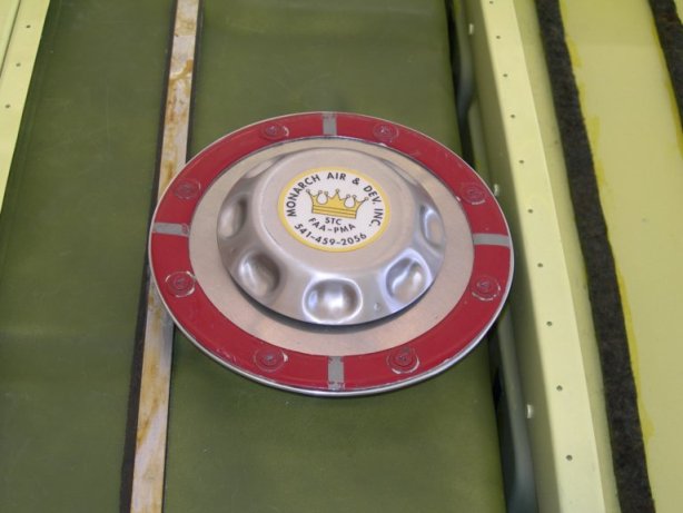

4. Unfortunately, the anti-siphon valve will have to removed.
The original tank inlet interferes with its operation. If you want to retain it, the tank will have to modified. This is never a favorite of the FAA.

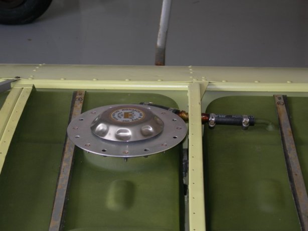

5. After installation on the tank. A small band of PRC1422 was appplied to the flange from the edge of the mounting holes to about 1/4" inside of the raised portion of the cap adapter. You can see the bend in the adapter plate, which installs just outside of the seat for the original cap. The hole in the back of the filler neck is there to allow the vented cap to perform properly. It also allows you to see if at least see part of your sealant bead after installation. A tank pressure test is required after installtion. (Be careful not to overpressurize the tank, it will ruin your day.)

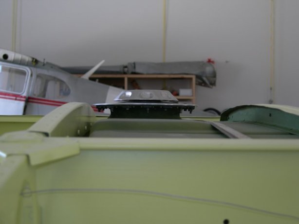

6. Tank installed.
7. Tank installed.
