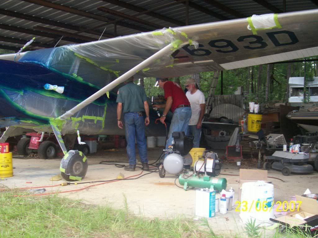

here's a mo' better pitchur of Ol' Gar Panting: (git a load of thet gimme-cap glow-inna-dark brim! ... he's so brite....his muther usta call him "Sonny":
50th Anniversary of Flight Model. Winner-Best Original 170B, 100th Anniversary of Flight Convention. An originality nut (mostly) for the right reasons.
That looks more like a government project, two supervisors and one worker.
