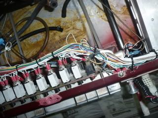

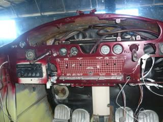

I have just about finished the rewire in my '51a. I used the Klixon 7277-2-xx CB's. The reason I went with these is that the Ayres Thrush aircraft I worked on during my days as an AME (the company I worked for was the Australian Agent/Importer and had a fleet of 14 of these when I was an apprentice) used these and they always proved reliable even in harsh environment of a crop sprayer. I not saying that the others are not as good, but I like to stick with what I know. I also like their compact form. While I didn't do anything as drastic as an IFR panel, I am pretty pleased with the results....
The original fuse holder holes are too big for the CB's so I cut a strip of alclad and drilled the holes in it, then put the CB through the original hole then the new hole. This means the CB's actually hold the strip in place. I made the strip long enough to go from the first fuse to the last covering the gap in the middle where the hand mic used to be. I could fit another three CB's in this gap. Also I used wire 'pigtailed' from CB to CB as a bus bar. I'm not a fan of solid copper or al bus bars.Theres too much exposed live power for my liking and it makes a much bigger job of swapping a CB as you have to undo the whole bus instead of just undoing one terminal. Not much fun when screwed up in a ball under the panel.

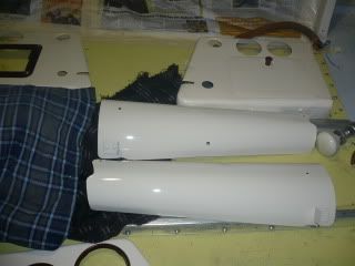

Of course I couldn't stop at a rewire, as you can see the panel has been painted which led to the trim pieces...

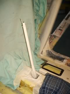

Which led to the flap handle...

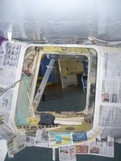

which led to the door jamb...
