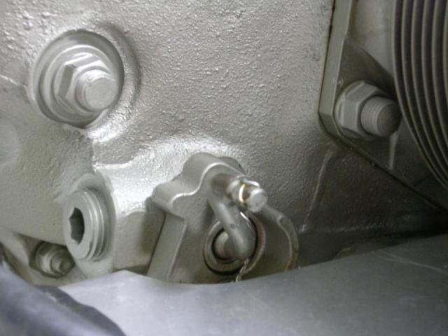

See below. It is just aft and below the nose of the engine on the L side. Visible thru the cowl inlets when the cowl is on.
It leaks just a tiny bit of oil - consistent thru the time I have owned the airplane. What is it for? It is safety wired in one position.
According to the parts manual, it is for hydraulic propeller control - didn't know that was an option with this engine... ? (I know not on the 170, but I didn't know the C-145 had the option).

If I remember correctly that was for the McCauley two position propeller. Low pitch for take off and then a cruise position also. About a year or so ago we sent one up to Werner Prop in Tucson for consignment sale.
According to the TCDS it is approved on the 170A&B with the C145-2H engine. Prop is the McCauley 2B36C7 with 78K-2 blades Brian
Was the two position prop designed to be adjusted in the field? Looks like it might be hard to do - and - must the control be safety wired after each move? Seems to me a good idea - if I could change prop orientation in the field - say on a grass strip high DA for the climb out - and then readjust the prop for the trip home. Otherwise, why not just change props?
The 2 position prop is adjusted with a cable. We recently had a picture of one of these, the only one many long time TIC170A members have ever seen, posted here at the forum. The pictures where taken at Petit Jean 2005.

I have one of these on my 0300-B. Wish I had a new McCauley two position prop to go with it I have had a slight leak at one time or another. Nothing to be concerned about. I have seen other "B" engines where the item was removed and a piece of metal the same size as the boss was placed over the area and it stopped all leaks. Member David Bengtson of Van Alstyne, TX has a cherry '56 170-B with the 0300-B engine & the only two posiition McCauley that I have ever seen. Really sharp looking.
