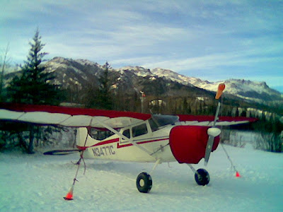

Just switched from 7.00's to 8.50's (Goodyears.)
Using them to fly in and out of a strip that has too much snow for smaller tires but not enough (really) for skis. But I'll probably keep them on since most of my trips are pretty short and the extra drag really isn't important to me.
Here's a photo of it tied down with the 8.50's.

Does your 170B have at least the lady legs? A couple folks have said look out for in-flight vibration with 8.50's and weaker spring gear but maybe that is an OWT. I have the lady legs and even in the yellow arc there is minimal vibration noted on the pilot's side.
Brakes are somewhat of an issue. The single pucks are safe but marginal. I did note the difference in braking with the new tires. I will be getting double puck brakes and C180 gear legs sometime this year after the bank account builds back up some.
